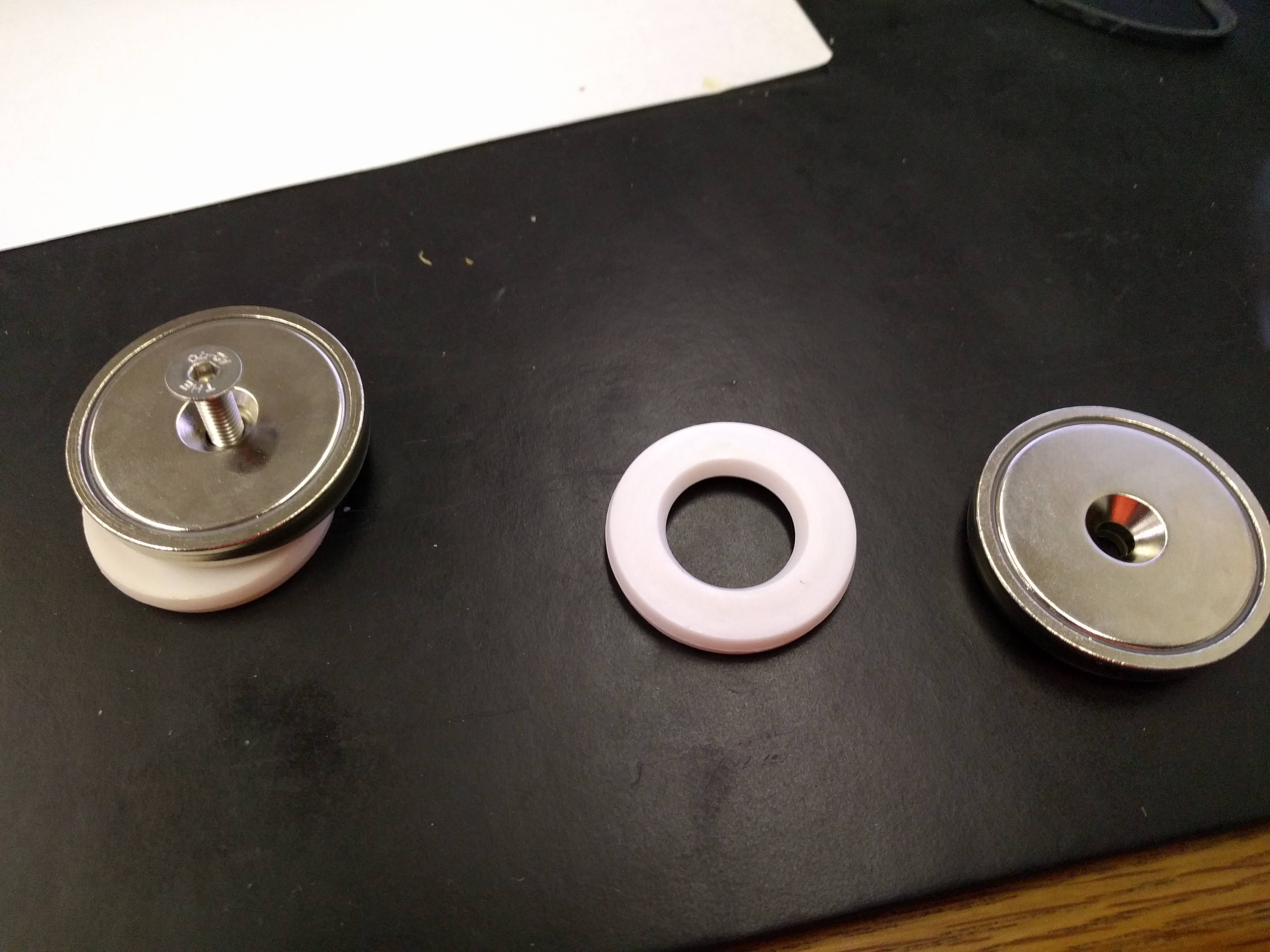

    I just got my 30Q Wolf Pack and its in the charger. Earlier today I read Karl Gesslein's review of same and noted his recommendation to add some Hailong type washers under the magnets as shock absorbers. When I opened my package up, I found some hard plastic washers... what are those for? Do they go under the magnet like on the left in the picture?
    • HIGHVOLTAGE
      HIGHVOLTAGE commented
      Yes they do, they're spacers to prevent the magnets from bending into the frame.
    • MoneyPit
      MoneyPit commented
      Perfect thanks! I'm heading home now to go install it!
    • Joe Remi
      Joe Remi commented
      I actually used both at first, the Hailong rubber things and hard washers. The rubber doesn't do anything but squish out of the way, you'll be fine with the stuff provided.
