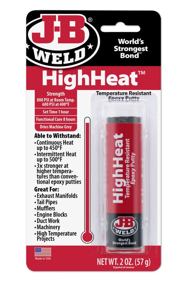

    • Tommycat
      Tommycat commented
      This has gotten recommendations, as well as Super glue (Gorilla brand)
