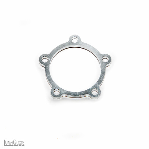

      You could also use a chainring spacer to push the Eclipse out a little further to match the Lekkie. Might be a cheaper alternative.
    • Cavi
      Cavi commented
      I thought of that but I currently have one of those plus a couple of washers and really did not want to have to go further, I should have the Lekkie by the end of the week, I am hoping this will cure the issue
    • paxtana
      paxtana commented
      Lekkie is not going to fix the chainline issue if the Eclipse did not. Eclipse has better offset than lekkie on any tooth size 42t or larger, and if your chainline is wonky you need it to be inbound, not outbound. See the offset comparison page.
      Yes it can be intimidating to rework a cassette if it is riveted together but cassettes are easily changed out, and that link I provided goes over a version that is easily swapped around. Or you could just switch the hub to an IGH.
