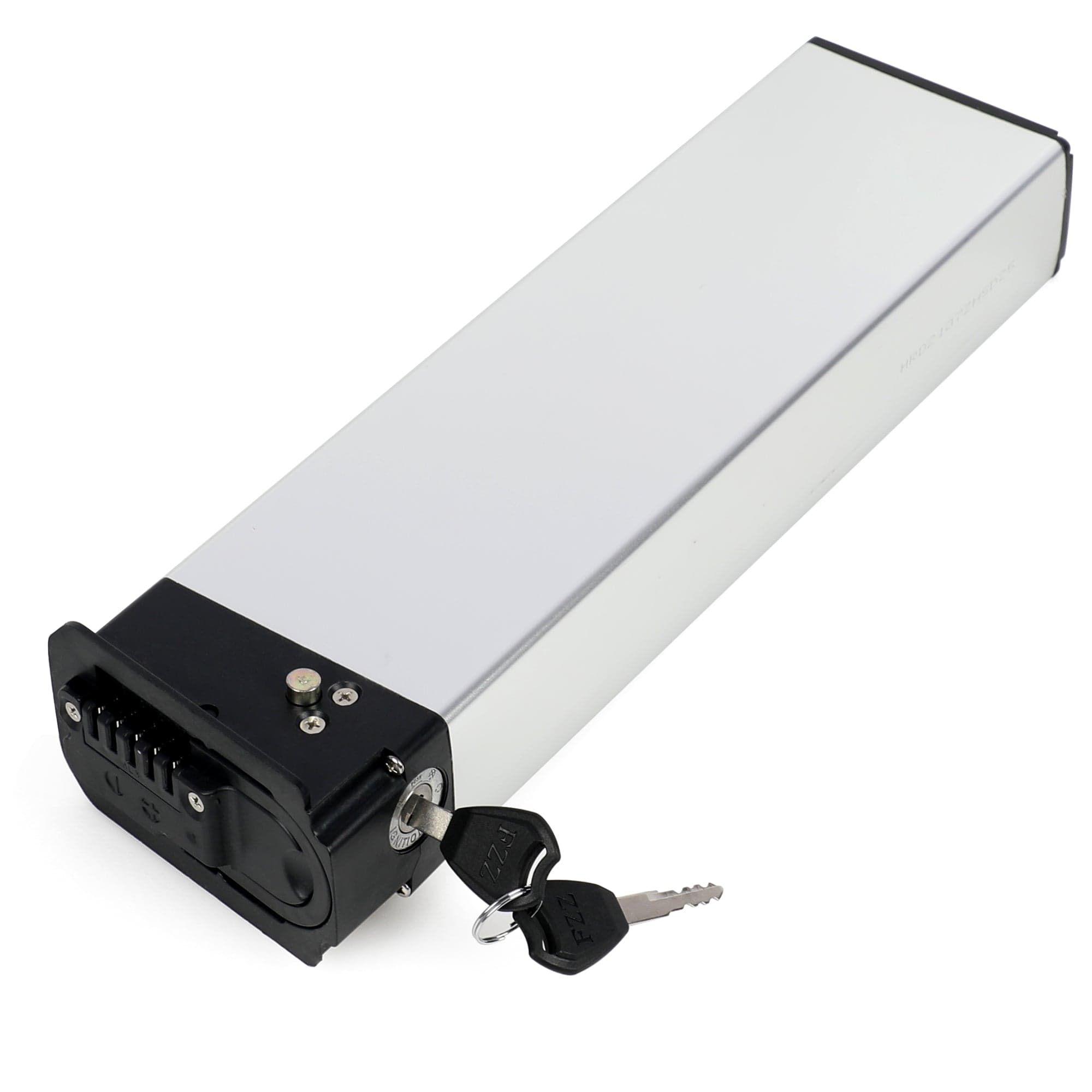

Is this the same battery as the Eclipse (obvs different AH). Luna doesn't have any extra batteries for sale for the bike yet.
Extend your range with a secondary battery. Each battery is built with premium battery cells for long service life. ✔48V 15Ah battery for older STT models. The battery lock is on the side of the battery and the battery power needs to be opened with a key. ✔48V 17.5Ah battery is for the new STT, the battery lock is on t
Why would they do that? Enclosed battery and motor specific controller.Last edited by Neverlost99; 06-19-2022, 04:26 AM.
