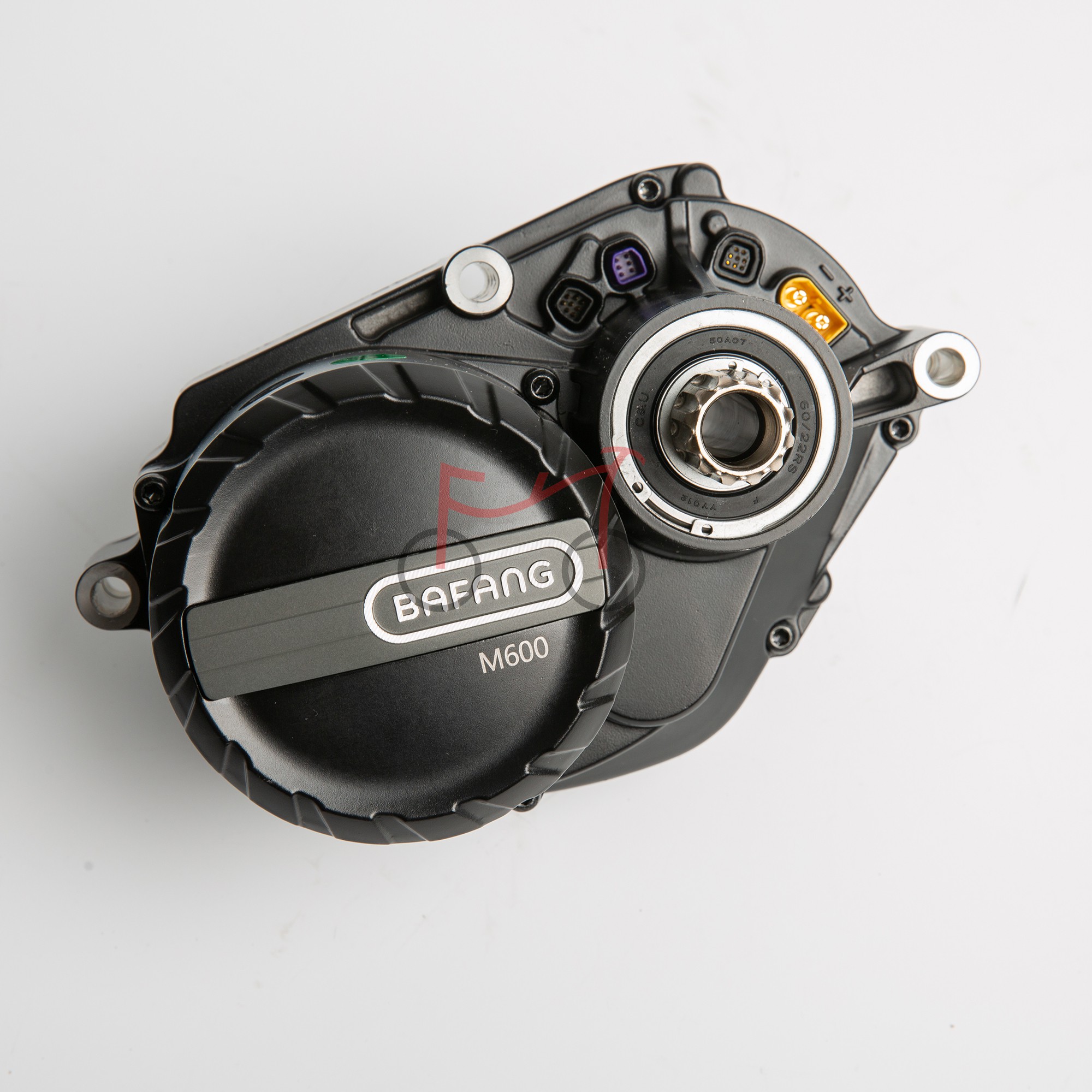

    I need to upgrade the crank arms..(mine got stripped)and luna is sold out. Its difficult to find 150mm crank arms that fit the m600 bafang spindle.

    Biktrix has a pair, here.​ For short ISIS-syle crank arms without chainring spiders, I'd also look in the Unicycle world - like these examples.
