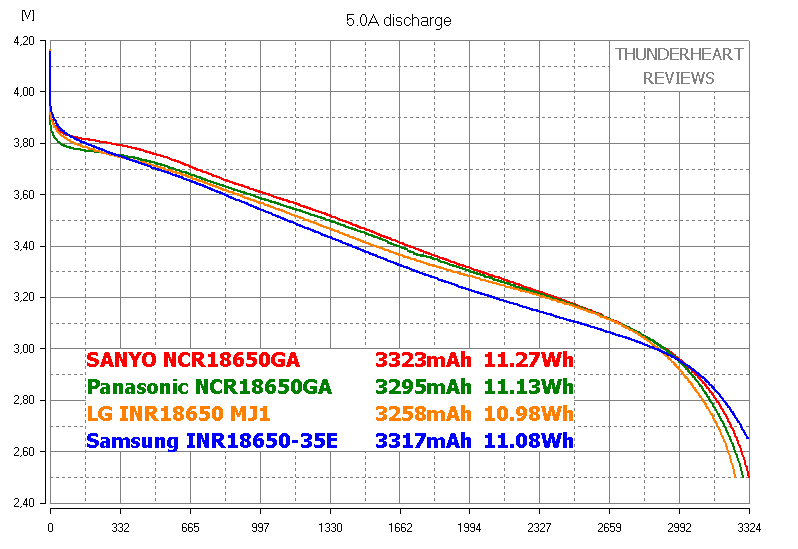

5A discharge:
Sanyo takes over Samsung thanks to it’s 2.5V discharge cut-off voltage. The battle between Samsung and Panasonic for the second place is lost by Samsung because although it has higher capacity (3317mAh vs 3295mAh), Panasonic has higher energy: 11.13Wh vs 11.08Wh. So Samsung is the third and LG is the fourth as expected.

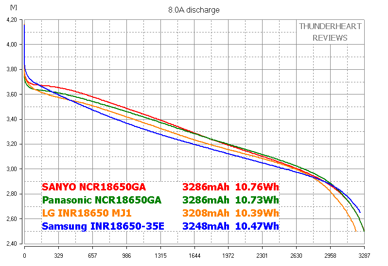

8A discharge:
The two NCR18650GAs showed the same capacity, but the Japanese one has 0.03Wh more energy given out, so the first place is occupied by him. The third is Samsung’s nimble 35E and LG is… yes, the fourth.

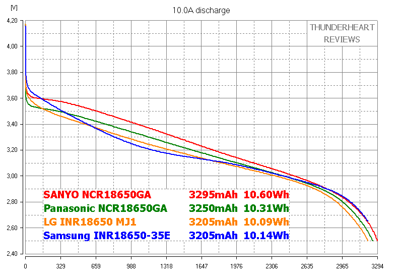

10A discharge:
Sanyo proves that he is number one and there can’t be another opinion. The difference between Japanese and Chinese NCR18650GAs is 45mAh / 29Wh. Panasonic is the second, LG has lost the third place to Samsung despite its specs.

5A discharge:
8A discharge:
10A discharge:
