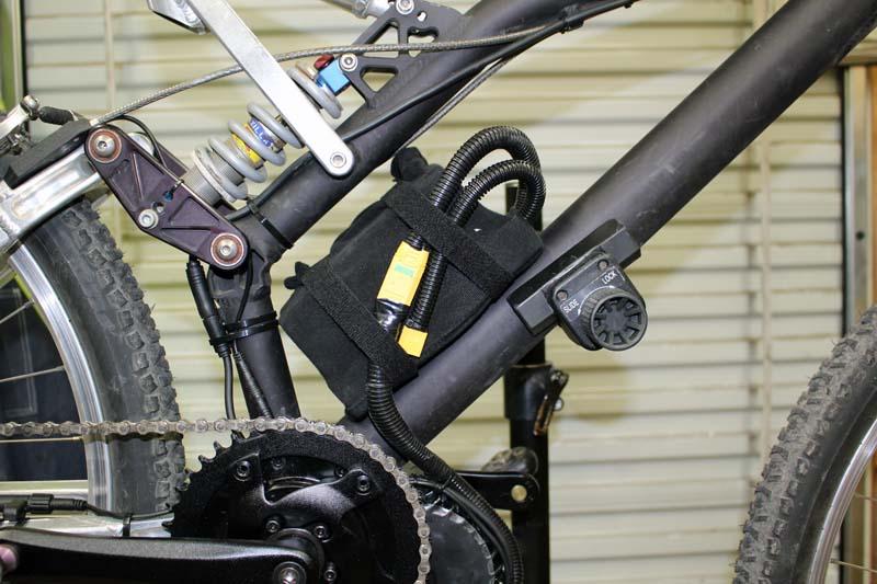

        Yes, it willl hold 2 mighty minis. I made an aluminum tray to hold the battery, and I can mount another one in front. I cut up one of my wifes old stretch leotard and stretched it over the battery and frame, and added a couple of velcro straps to hold everything in.

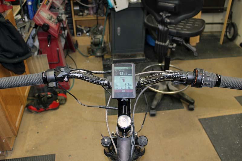

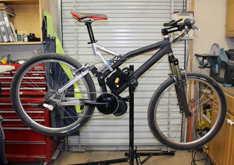

        Here are a few installation notes. The motor housing hit the lower arm pivot bolt (right behind the bb) on the chain side. I added a .080" spacer between the motor housing and bb. I also added a .060" washer between between dog eared mounting hardware and the bb to get the adapter to sit flush against the bottom bracket. I screwed the locking ring and black collar on so it was flush with the end and measured the distance to figure out how many spacers I needed. I used an old Park tool (which was too big) to tighten the locking nut down. Next, I mounted the computer, throttle and ebrakes on the handlebars, then ran the wires. I mounted the gear sensor on top of the bare aluminum pivot arm next to the bolt. The only problem I'm having is the chain is at such an extreme angle in 1st gear the chain comes off. Someone suggested moving the freewheel closer to the frame. After a few test rides this morning I don't think I even need 1st & 2nd. Below are some photos.

            I switched to the Eclipse chain ring with a 2.5 mm spacer to get a straight line to 4th gear. A 5mm spacer also works. The chain hit the frame with no spacer.
            I went on a 12 mile rolling hill road ride to check things. Constant pedaling with pas1, also tried the other settings. I used less than 1/2 the battery charge with the Mini Might 52v 30q battery.
