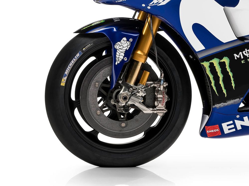

    I learned first hand about unsprung weight in my racing days. Changing over to carbon fiber wheels from normal forged aluminum ones made my 1000 liter vtwin made my bike turn like a 125cc two stroker! Anyway here is a good article that explains how unsprung weight affects handling, acceleration and braking:
    Unsprung weight describes the parts of a motorcycle that move up and down with the road. Kevin Cameron describes the importance of low unsprung weight.
