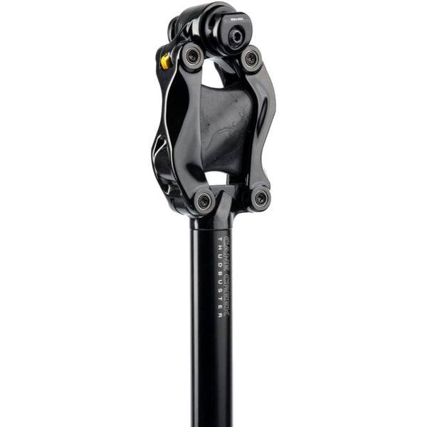

New Cane Creek Thudbuster LT 4G version.
    These have gotten to be up around $200 lately. I found them new for $129
    Cane Creek G4 Thudbuster LT Suspension Seatpost   90mm of travel for XC, Gravel or Comfort use Patented 4-pivot parallel linkage with PTFE bushings Pedal to saddle distance remains nearly constant through travel 2-piece elastomer design. Tool-free inner elastomer change for various rider weights Medium firm elastomer p
