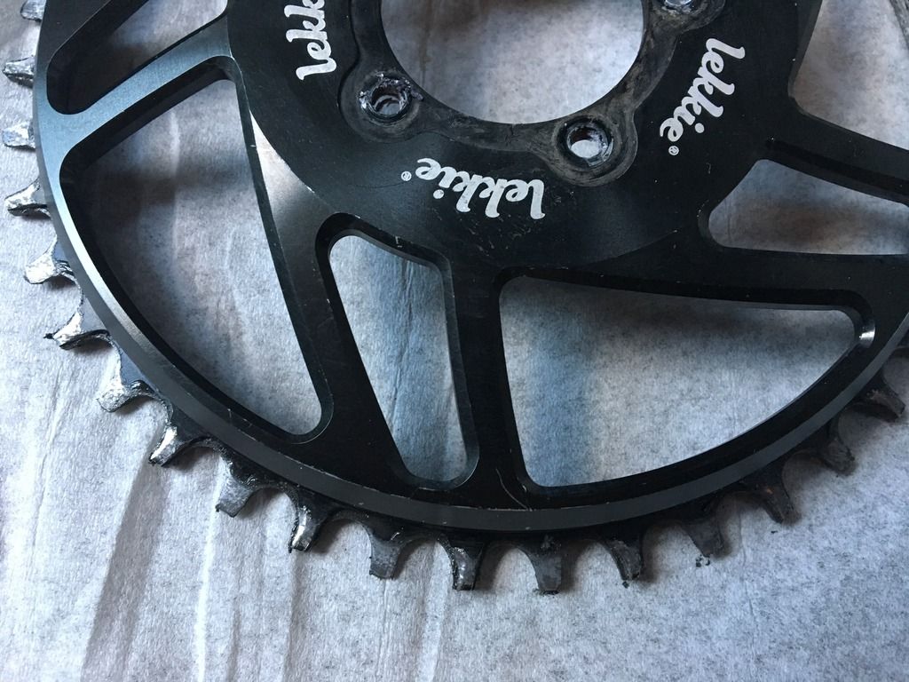

        After 4800 km the lekkie was looking like this... A lot of broken teeth. Time to get it replaced.
