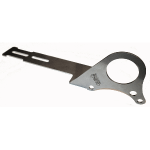

    the issue i have with the motor kept coming loose. regardless of how tight i bolted her up it would come loose. this would effect how tight/ loose the chain was. and even though it is igh hub with no derailleur. chain would jump off going over bumps
    had to get a few metal hose clamps. to keep it in place. interlocking two em around the motor and frame. while doing this noticed the teeth in the triangle brace had chewed massive lines in the frame from the movement.
    i have order a stabilizer bar which i hope will keep it in place. still moving a little bit with hose clamps.
