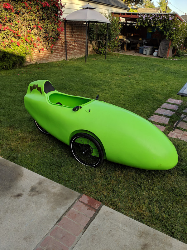

    The battery found its way to my current commuter. That leaves a motor for installation, but it is a bare motor (it still has the chainring). My intent, for this build, is to install it on a Rotovelo. Mechanically, a Rotovello is a tadpole trike.
