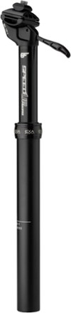

                Is this the drop post lever that you used? Mounts to brake lever?
                Shop for Dropper Posts at REI - FREE SHIPPING With $50 minimum purchase. Curbside Pickup Available NOW! 100% Satisfaction Guarantee
                • Monkey Bike
                  Monkey Bike commented
                  Yeah that’s it! I would definitely recommend the OneUp remote dropper lever
