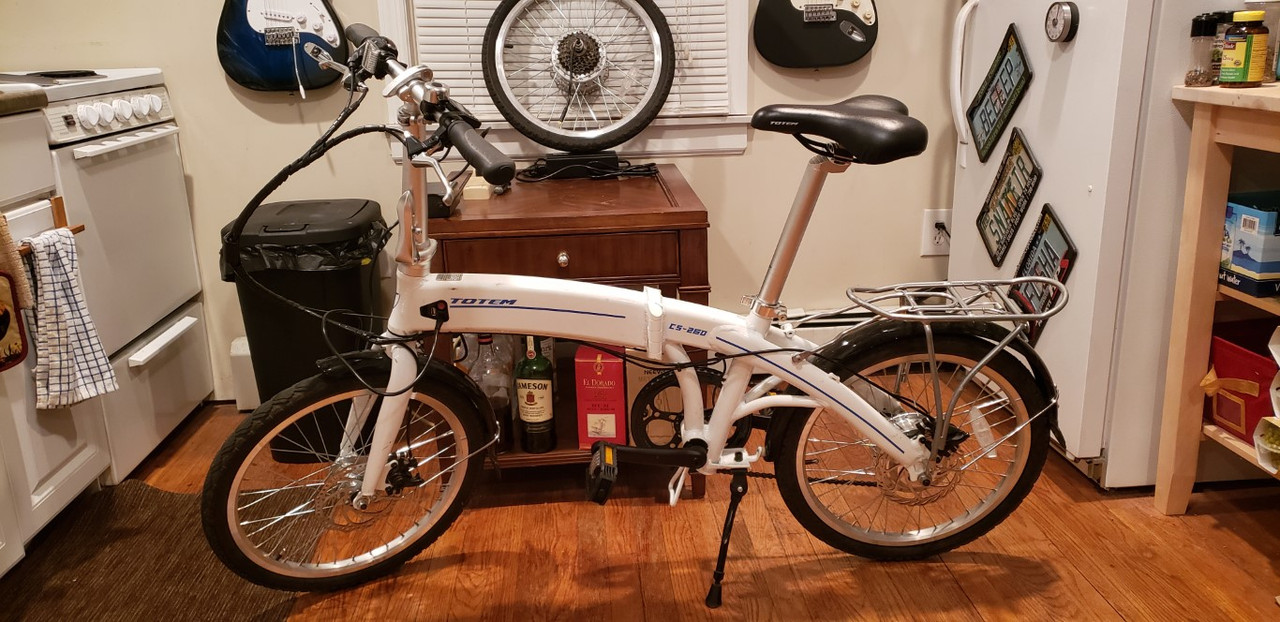

    Anyways, we've been enjoying it, but I'm curious if there's a way to unlock the speed limiter of 15mph?
    I've seen it done on other controllers, but couldn't find any info one this one:
    Tried pushing "+" and "-" together and a 4 digit code setting came up, but I have no idea what it's for.

      Found the code on an Amazon review (1919) and was able to change wheel size
      I can defnitely see a difference, but of course the speedo is off, so I'll have to do GPS and SOTP tests tomorrow
        Was there a speed limit setting in there? Sometimes it is and other times it seems you need to get deeper often requiring some sort of programming cable sort of thing.
        From what I have seen the wheel size setting is kinda vague and its best to verify it and try other settings if its off and hope you can find one that is close. My bike with 26x2's is closest with it set to 24" and my other bike with 26x4 or 29x2.35 is at 27. Really not sure what sense that makes but according to the 'your speed is' speed trap sign near my house they are now both accurate. Previous owner of my first bike apparently never even found the basic settings screen so was reading in KM with the wrong size tire. Guess that is one way to do it, select the units you know the least, that way you really have no idea how far or fast you are going.
