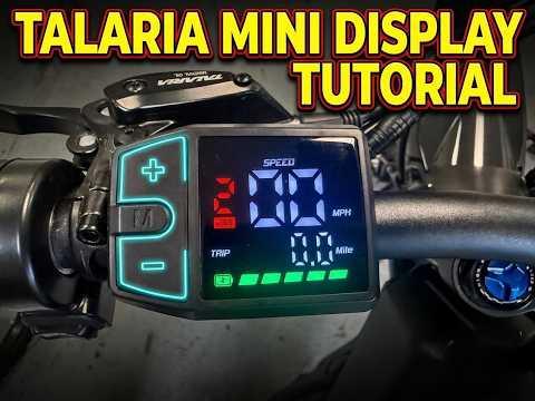

    The updated display on Talaria XXX Mini shows speed as KM/H as default out the box. A common question we get asked is how to update this, so here is a quick guide!
    Quick button sequence: Hold bottom button > press M > press + > press M > hold M
    Before changing the setting, park the bike and keep it stationary. You only need the four buttons on the display: The button on the bottom of the display, +, M, and -.
